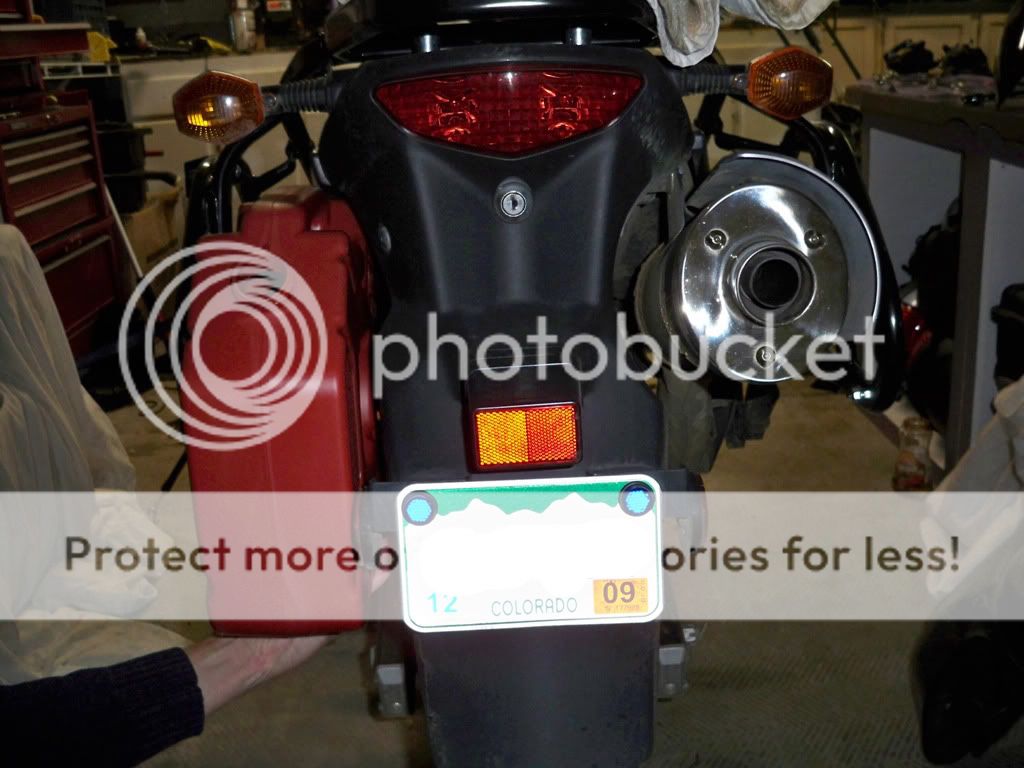

Alaska is on the brain, with a trip planned for this summer with fellow Strommers. Since I'll be the only one on the Wee, I plan to make the most of my one advantage: fuel range. To that end, I see an opportunity for an aux fuel spot where the second muffler would otherwise be on the 1K. I stopped by Gander Mtn and picked up a Kolpin 1.5 gal fuel container. See pics:
It's not as clean a fit as I hoped, but it might work. They also make a water container (white plastic) that might fit better.
Any other ideas?

I like the idea of it being behind your pannier mounts.
I see alot of gas cans that are strapped on and are very exposed. If your in an accident and hit the ground.. there is going to be gas spilled and there is going to be sparks!!
I think where your going to put it at least you'll have some protection and the extra weight will be offset by the stock exhaust on the other side.
That thing looks bigger than 1.5 gallon for some reason.

I like your idea. I was thinking along the same lines for after I chop one pipe off of my V.
If you haven't seen them yet, Rotopax makes a similar gas can system that, by all accounts, is a much better product. The Kolpin tanks are universally maligned as having leaky lids and pour spouts.
The Rotopax are a little longer and taller, but are 1.5" thinner (so it may fit better) and hold 1/2 gallon more. The Rotopax are rotationally molded, rather than blow molded, so they are stronger, too.
Kolpin: 1.5 gal 11 ½" W x 4 ½" D x 12" H
Rotopax: 2 gal 17 3/4 W x 3" D x 13 1/4 H
I also like the Rotopax system in that you can lock two cans together. It would be really nice to have two gallons of fuel and two gallons of water along in remote areas.

This looks like it would interfere with suspension travel.
It is pretty close. The pic doesn't show it well, but it was fairly close to being clear. To be sure I'd have to settle on the mounting height and compress the rear shock to check. However, the Kolpin is 4.5" wide and the Rotopax is 3", which would help. I'm holding out until some adjustments are made at work before I try the Rotopax. Gimme a couple of weeks....maybe...
