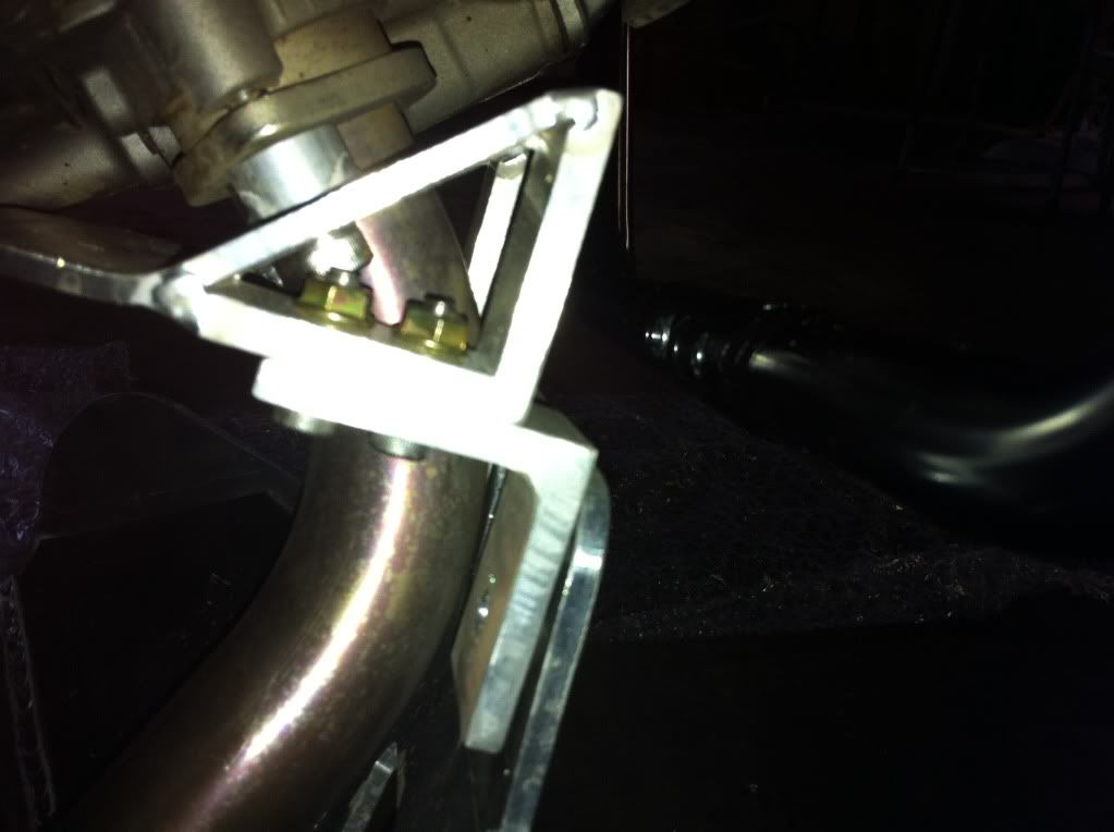

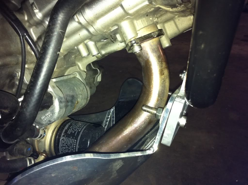

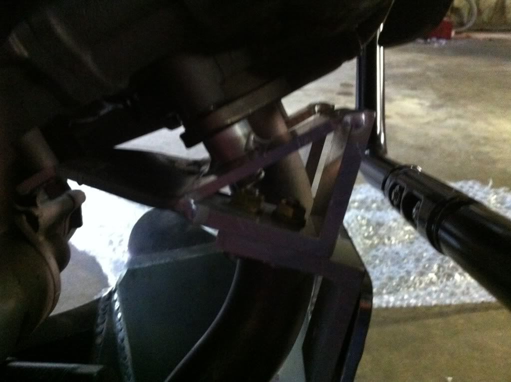

My simple fix
This is the B&B bracket for the 2012, ugly as a hat full and yes it does bolt to the exhaust flange

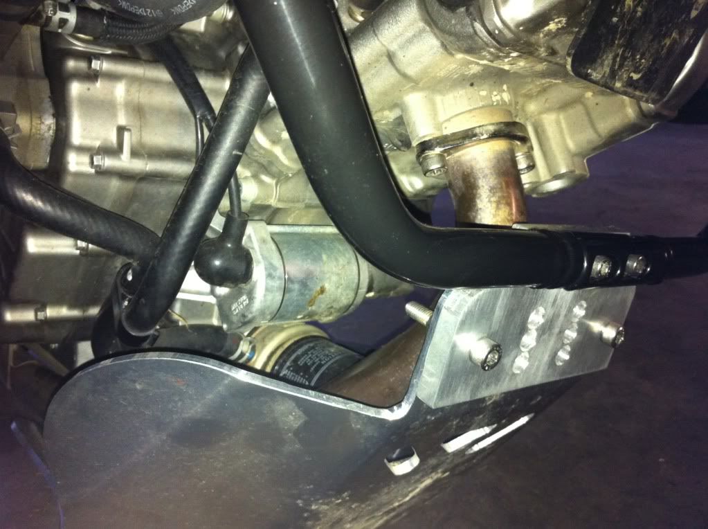

I have SWmotech crash bars and this is what I have done to get away from the B&B idea.
Its just a piece of 140x75 10mm flat ally bar that i shaped and drilled some holes in and it fits perfectly

Picked up new white V-strom, fitted with Scorpion bash plate and SW-Motech crash bars, and all went well.
Some pics attached

Given that the B&B mounts to the front cylinder head, if you need to remove the bash plate for an oil-change, or for whatever reason, does the mount stay in place or are you having to remove this every time you remove the plate?
Whilst I don't mind disturbing the bolts once when I fit it initially, I don't much like the idea of mucking about with head bolts every time I need to remove the plate.
If I modify it to mount to the SW-Motech bars as shown in the excellent pictures above, is the mounting as strong as the original system? Not, I hasten to add, that I'm intending to drag it over rocks & logs!
I really like the look of the B&B bash plate.... It's simple, elegant, beautifully welded and looks to be very sturdy & I also love the idea of supporting Aussie made.
The plate itself comes off quite easily without removing the bracketry.
