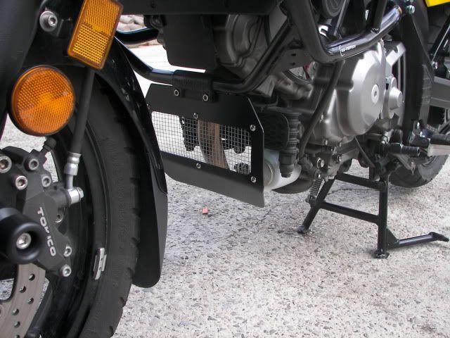

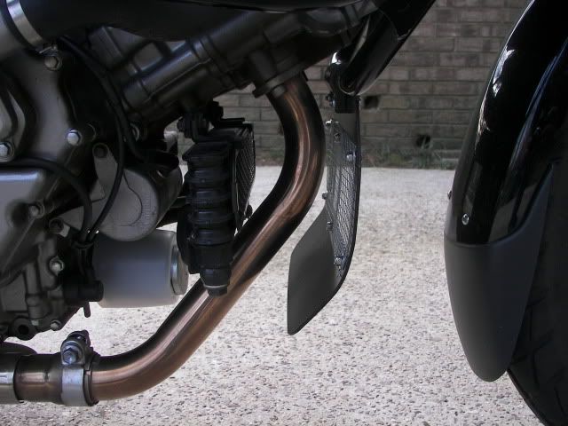

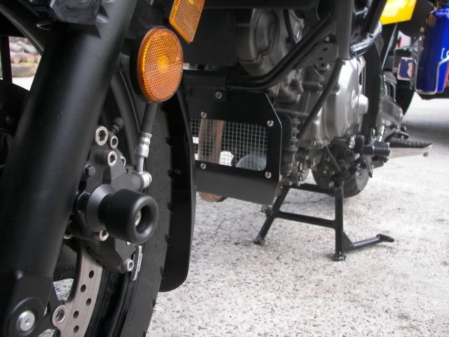

Planning to ride to Alaska someday........can't hurt a guy to dream, right?? I have a full-size skidplate that I won't install due to its weight (13 lbs).......and I don't plan on doing that kind of riding anyway......might be a mistake, but my mind is made up. For oil cooler, radiator, and oil filter protection, I have added a Fenda-Extenda and aftermarket cooler/radiator guards.......along with a plastic "condom" for the filter :biggrinjester:
For added protection, I built an additional aluminum "stone guard" (i.e. the cow-catcher name) for debri thrown up from the front tire. Time will tell if it helps.......

good idea. I took a few large rocks off the skidplate, kicked up by the front wheel, your cowcatcher would probably stop that happening.
