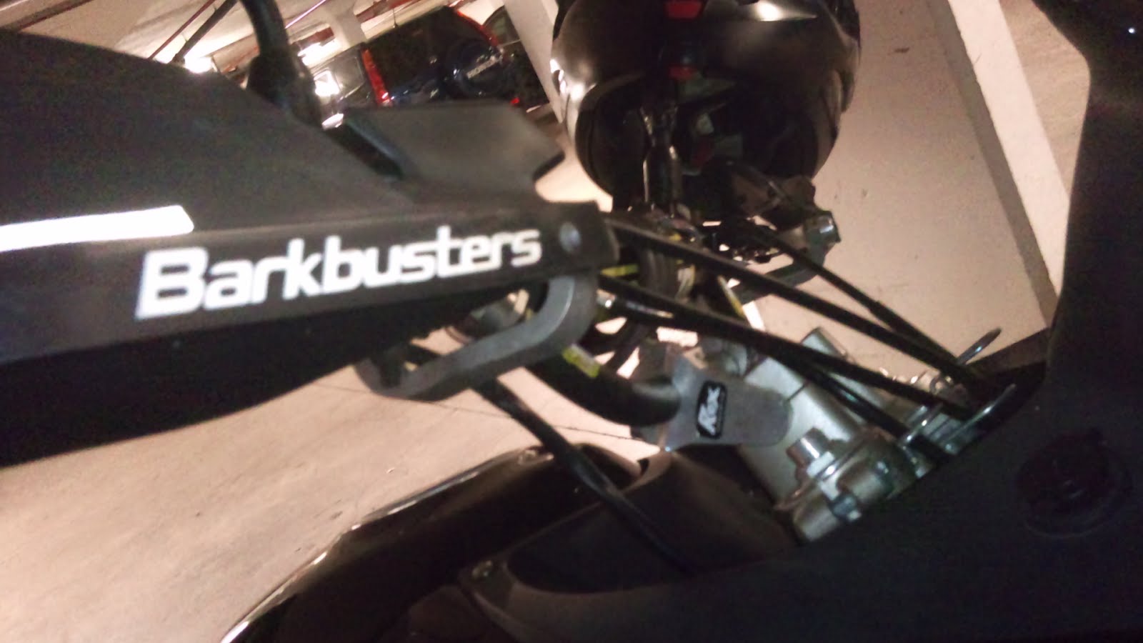

I say CHECK IT OUT rox 2 inch risers + pro tapers atv high
To instal the Rox Risers just tight the lower bolts as hard as possible till you can still move the handlebars, then position the pro tapers bars where you want, finally tight the top bolts. Same applies to the rox risers bolts. I am pretty sure the same will apply to any other type of 2 inch risers. I didn't do *the brake lines myself
you will have to release the electric wires from the zip tie and cable holders
don't lose the washers as I did, by any chance do you guys know the size of the washers? I have to buy one now but don't want to take the bolt out to find out

It was fun actually !!! playing with the bike on the side of the road dodging cars trying not to lose the bolts. I lost 1 washer actually.
But I still think I am very far away from servicing the bike myself
I was soo exited that I went to Woolys to test ride the risers and take some pictures on the parking lot (of course I said we needed milk)
