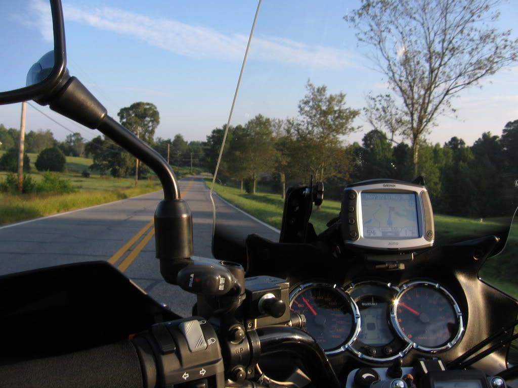

I attach the Zumo directly to the SW-Motech mount with the provided hardware that came with the Zumo. When I leave the bike unattended I just pop the Zumo off it's base and put it in the trunk.
Actually the best position I've found for a GPS on the bike. Hope this helps.
EDIT: Almost forgot, removing the Zumo from it's base is made much easier with the following security replacement screw.

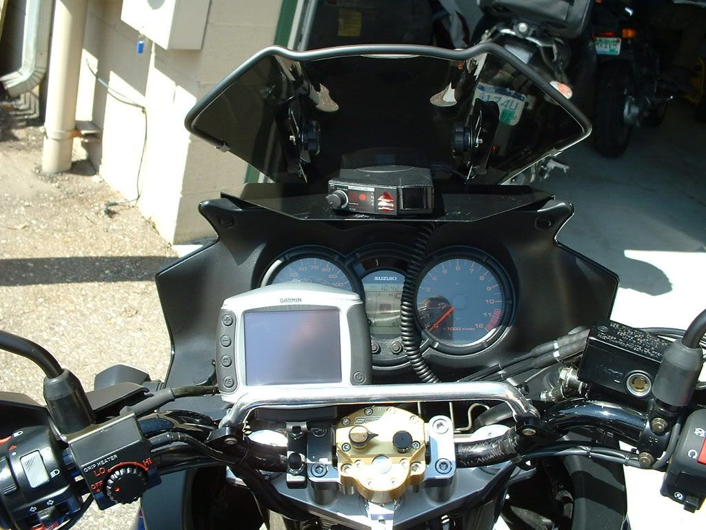

Here's Mine
I like this alot. It blocks the stock speedo which is totally inaccurate anyway. Used only what came with the Zumo 550 kit.

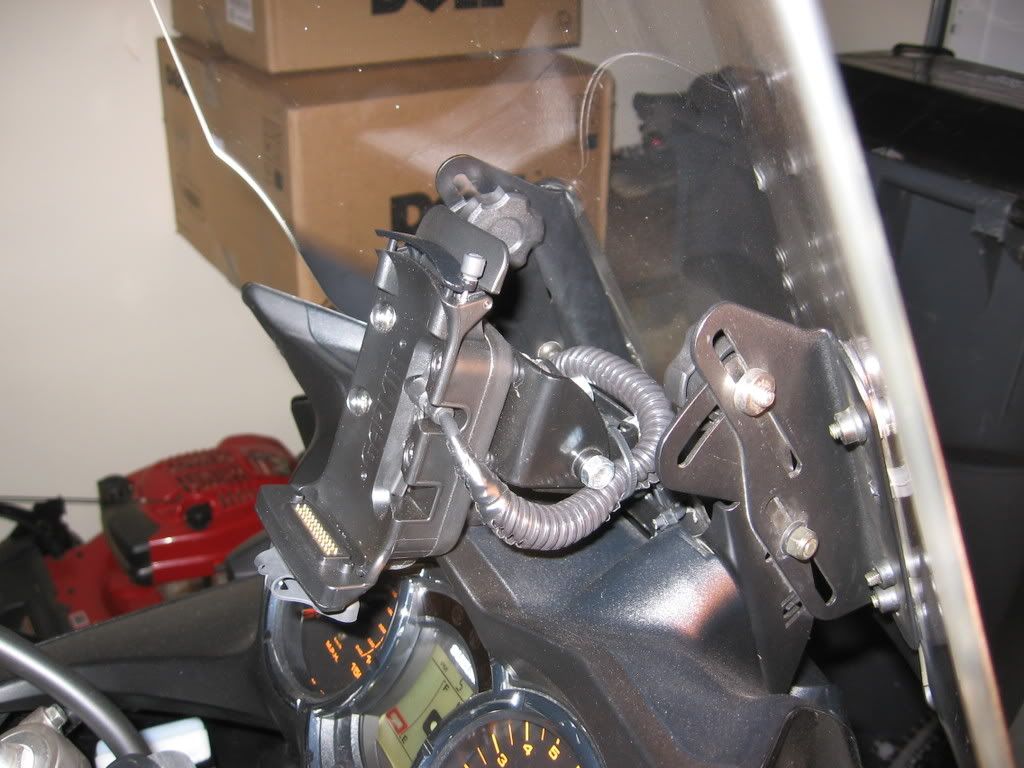

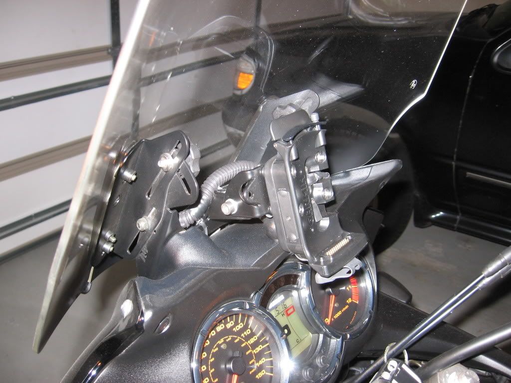

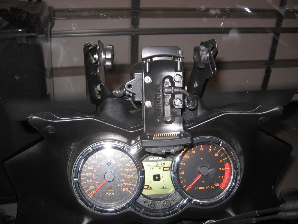

First welcome to the forum Francoiscqc!
You have the same setup as I do however you will need the SW-Motech mount. This mount, and I believe all the photo’s you will need, is on the Twisted Throttle web site at the link below.
http://www.twistedthrottle.com/trade/productview/2596/
With that mount and the base that comes with the Zumo it’s a simple process of bolting the SW-Motech mount in with the windshield bolts and then bolting the Zumo mount onto the SW-Motech mount. I think I might have had to drill out a couple of holes on the SW-Motech mount for the bolts that came with the Zumo. If you still have questions let me know and I’ll see if I can get some photo’s up.
* * * EDIT (1-25-09)* * *
Took a couple of photos tonight. Would have been better during daylight but I didn't have the time. Hope this shows you what you're looking for.
