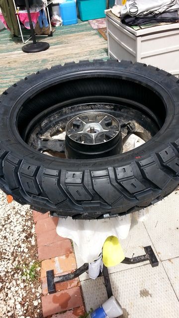

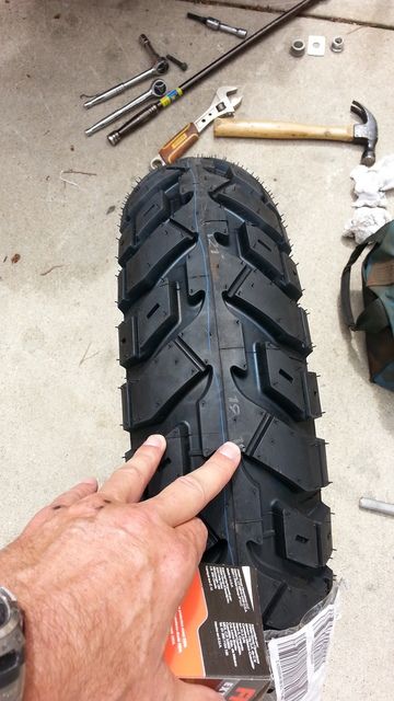

I added a tooth on the rear sprocket (48T) and got this Avon AV85 TrekRider on the wheel (spocket weights don't work since the spokes are in a reverse orientation on the 650XT - weights fall to the wheel hub). I'll get the wheel on the bike tomorrow. The Avon AV54 TrailRider sitting there only lasted 6500 miles (fun-filled) and wouldn't pass the state vehicle safety inspection due by end of June.
Raining this week. Full report later.
BTW: #1, the Avon AV53 TrailRider front is still in good condition, so I'll continue to use it. #2, I used balancing beads in the AV53 and you can see how it polished the tire's inside. #3, the center section of the Avon AV53 is very flexible and gave a good ride although shorter than I had hoped. There was very little variation in tread depth down the middle, so I'm assuming that the balancing beads either corrected the imbalance or did no harm to an already balanced tire.
