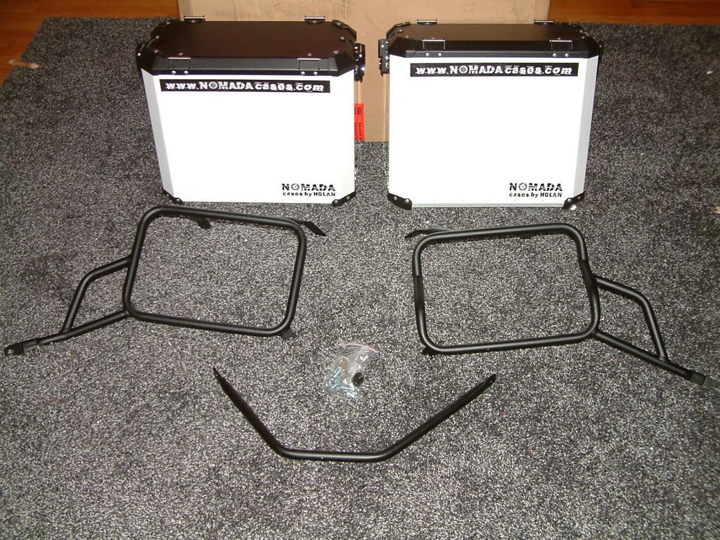

I ordered them mid-January from Holan in Poland and they took about a month to arrive (shipping took 8 days). They arrived today and I could not wait to unpack them. I believe they may have been made to order which is why the long delay. At first look, the wait was worth it. They appear to be quite well made with a very good finish. I took pictures that follow. They came with stickers which immediately were removed.
This is the whole kit (also a dog chew bone in upper left of pic) once unpacked:

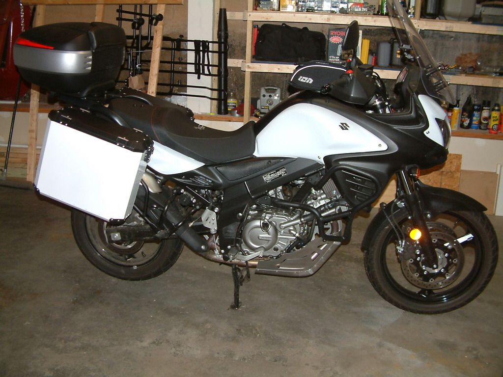

I said it would not be long and, fortunately, I had a little time tonight, the cases are installed.
[IMG][/IMG]
Just one pic here although there are a bunch more on the original photobucket link. Short review is the are very good to excellent. A couple installation hurdles but nothing bad. I will provide much more detail when I have time to write the long review. Wish I could ride her...

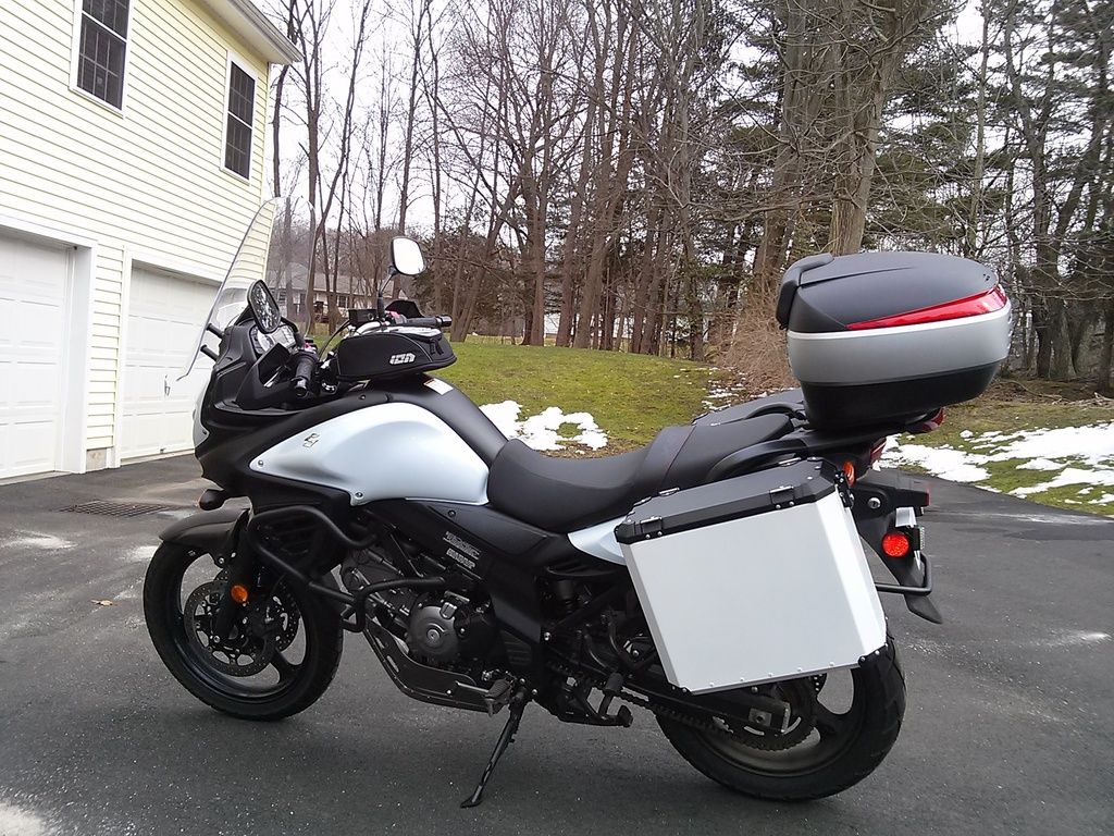

New Pics (outdoors) added to photobucket folder and one here...
http://s304.photobucket.com/user/vvo...20Nomada%20Pro
[IMG][/IMG]
50+ degrees, headed to the dealer to drop her off for my recall.

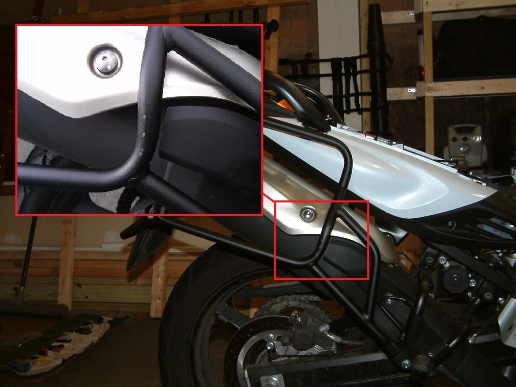

The installation of these panniers is fairly easy. Two bolts under the rear rack/grab handles and one at the footpeg mount per side. Plus two bolts on the bar that goes between the racks. Of course, this was not quite that easy. First off, the lower exhaust cover requires removal or a slight modification. I chose the mod route. Shaved off a little plastic with the trusty dremel tool (this was not the first and most definitely not the last time it will be used on my bikes).
[IMG][/IMG]
Once this was cleared for the bar, I found the bolt holes that line up under the rear rack on the muffler side were spaced ~1/8in too wide. Easy fix once I found the right items to do the work. A couple twists of the wrench and voila! Not sure if the spacing was a mistake at factory or due to shipping half way round the world.
[IMG][/IMG]

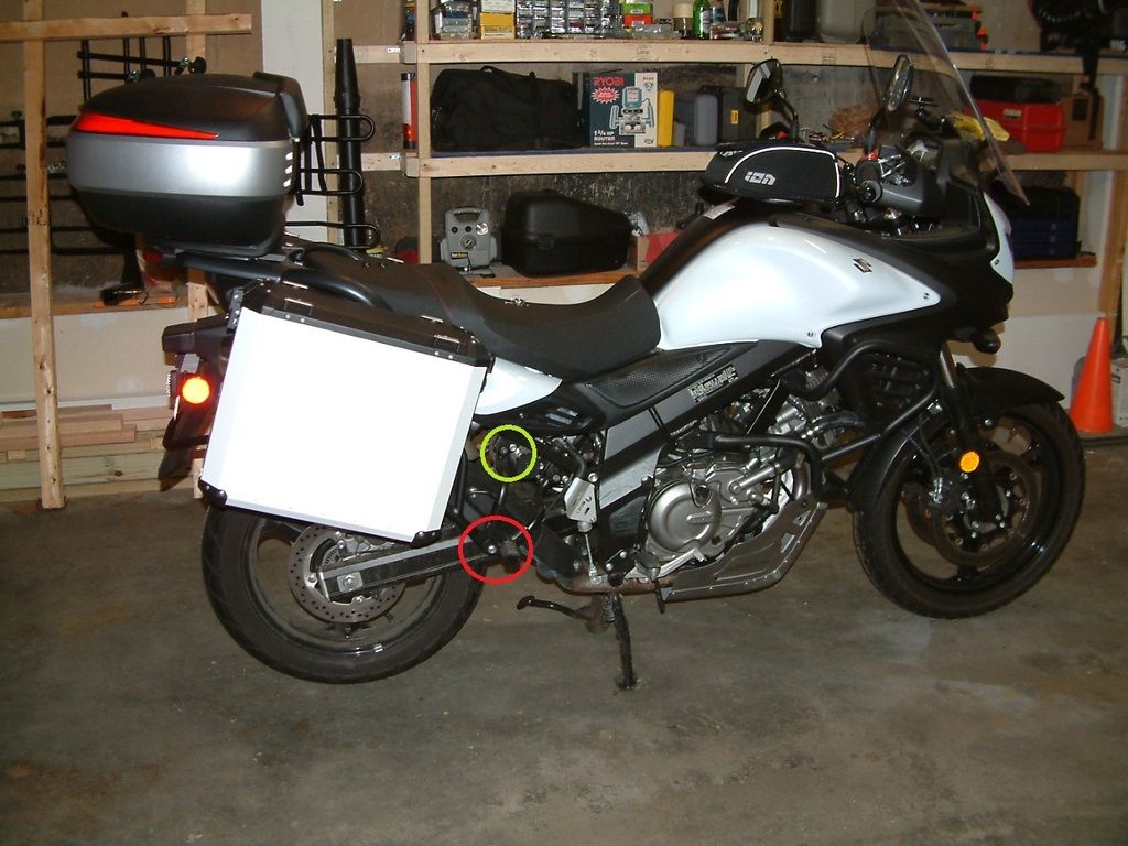

Everything else was as expected and perfect. I really like the fit of these panniers. They keep the width of the bike down but provide the extra space I wanted. I am undecided on my feeling for two things regarding the design of the mounts.
1. The lower-forward mount for each side carrier is located below the footpeg on the footpeg bracket(red circle). I think it would have been stronger utilizing the bolt at the green circle but there may be some trade off to pasenger leg room.

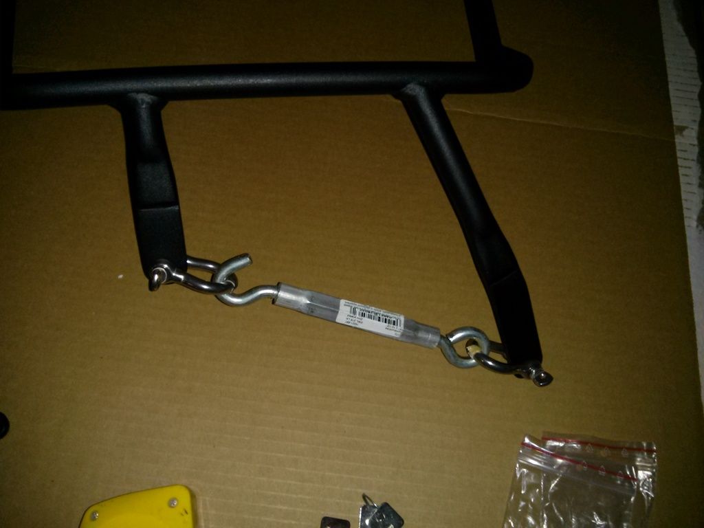

2. The support that goes between the left and right carriers goes outside the fender. This seems to be a good option but I do not "love" the looks. On the postive side, it may help protect the rear fender in case a bicycle rear ends me.
[IMG][/IMG]
