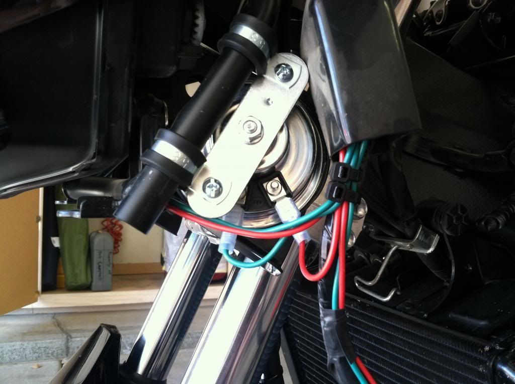

First of all here are all the pieces that I will be installing today, a Fiamm Freeway Blaster low tone horn, a high tone horn, a relay switch, an inline fuse w/ 20 amp fuse, and rubber covered clamps that I picked up from Lowes for $1.75 for two clamps. The horns also come with some mounting hardware and wiring parts that I did not use.
The first thing I did was prepare the bike for the work to be done. I removed the lower fairing, the seat, and tipped the gas tank up to make it easier to run wiring.
Here is a close up of the fairing support framework that I will be mounting the horns on.
Here you can see the first horn mounted up on the right side.
And now the left side.
This view shows you looking up at the bottom of the horns, they are pointed down and forward. They are the square looking openings on either side of the forks.
The next two images show some of the wiring details. In the plastic tray right behind the battery, I mounted the relay to one side with a bolt through the side. I drilled a hole in the front of the box to run all the wires through. The power supply with the inline fuse, is the large red wire going into the plastic tray. After consulting with other members here I decided to run the ground wire all the way back to the negative terminal on the battery. ( I was originally just going to ground it to the frame. ) the ground wire is the green wire going to the negative terminal of the battery.
Here you can see some of the completed wiring up by the horns. I zip tied wiring securely in place and tucked some connections up into a handy factory rain cover.
With the underside cowling back on, the horns trumpet is partially covered. It does not touch the horn, there is about a half inch of clearance. It does not seem to affect the sound of the horn.
