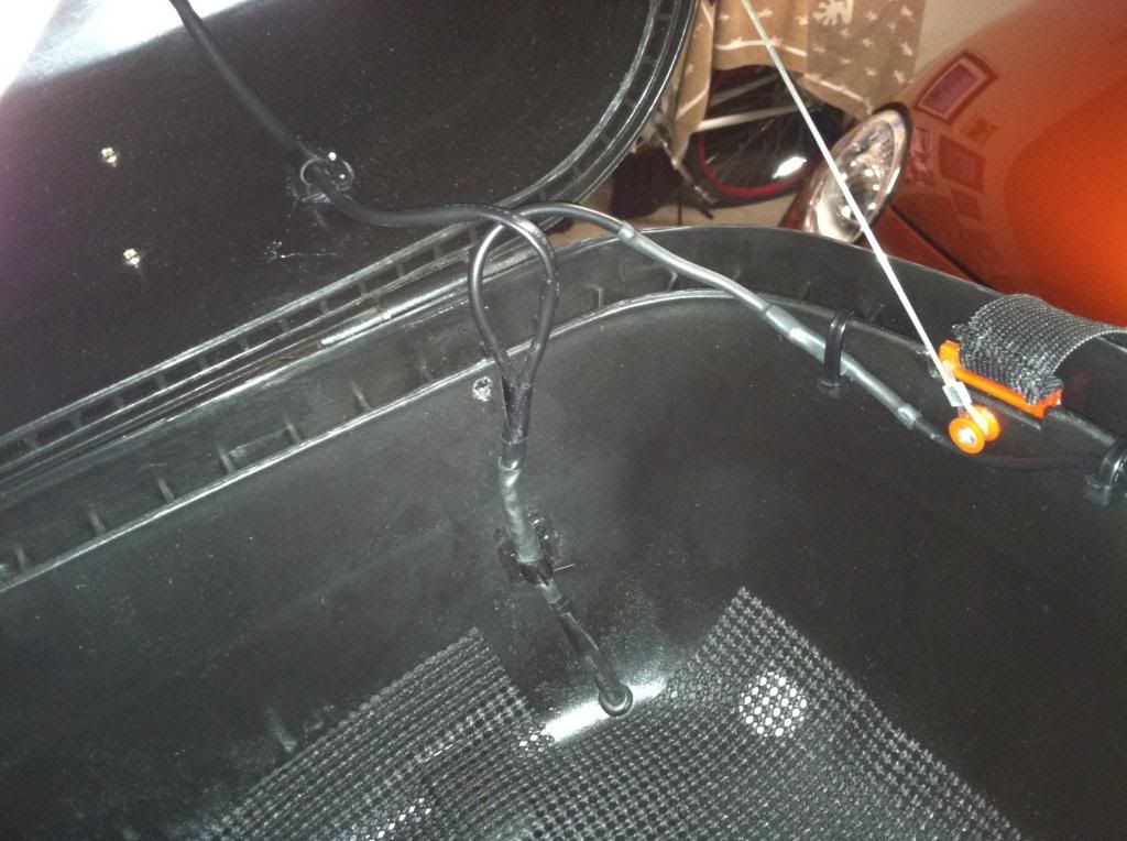

Ok, a little follow up on wiring the Bestem 929 with LED lights. The lid of the box has a small brake light incorporated in it, with 2 wires coming from it.
The lower half of the box has 2 bands of LED's running around the edge of the box under a red lens. That has 3 wires coming from it. So here are the wiring instructions.
( The Lid)
Blue = Ground
Brown = Brake light
( The Lower Box)
Red = Brake light
Black = Ground
Green = running lights
So, here's what you have to do, inside the box, connect the wiring in the lid to the wiring in the lower box. I will tell you what wires to put together in the Top Box and then what corresponding wire on your bike to tie into. I made all of my connections in the tail compartment by tying into the wires going to the tail lights. I soldered my connections, though you could do it with various electrical connectors, or really do a bang up job with some Eastern Beaver wiring blocks and specialty wiring harnesses.
TOP BOX............to.................... BIKE WIRING
Blue and Black............To....................Black w/ white stripe........... Ground
Red and Brown............To....................White w/ black stripe........... Brake
Green.........................To.................. ..Grey.................................Running
Note: for the ground, I didn't tap the bikes wiring, I put an eye terminal on the end of the wire and just connected it to one of the luggage rack mounting bolts.
(Disclaimer: my bike is a 2011 DL650, I have no knowledge if wiring harness colors are any different for various models and years. So do your homework and tap into your wiring at your own risk.)
This photo shows the wires after they have been tied together and then connected to a wiring harness that I made myself consisting of a black, red, and green wire that I then slipped into some heat shrink tubing. All the wiring included in the Bestem box is extremely small gauge so be careful not to break it. The material you see on the bottom of the box is just some non slip shelf liner to keep stuff from sliding around.

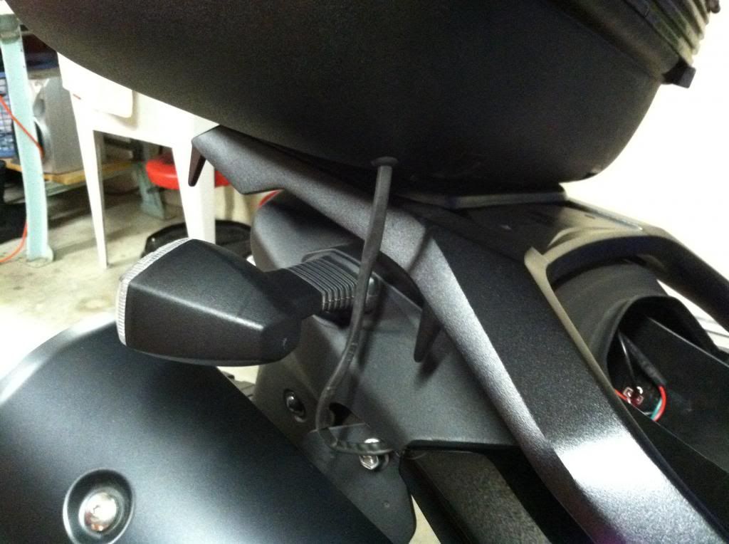

Here you can see the wiring coming out the bottom of the box. The hole is pre drilled and has a rubber grommet to keep your wires from chafing.
The wiring harness leads up under the tail and into the space in front of the taillight. I installed quick dis connect terminals in this space so the trunk could be removed if necessary.

I did something similar. I left the disconnects right below the box, so I can more easily remove. Its pretty marly looking nest of wiring, though.
Nice write-up. Thanks.
