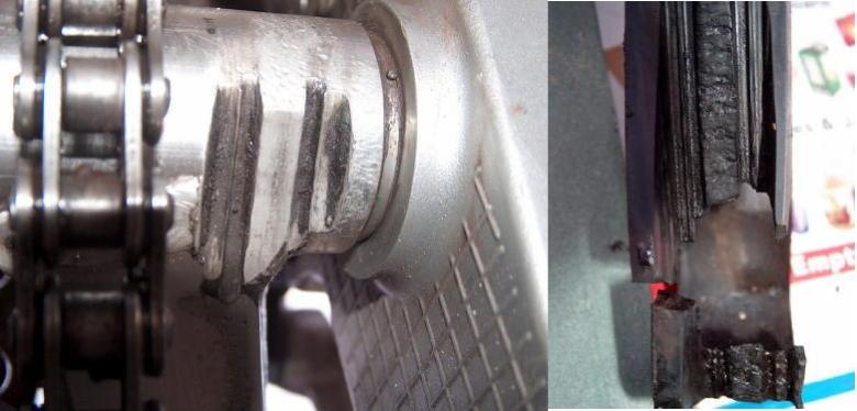

It's #9 on the parts diagram. Don't have a pic to post here, but how often do you change it out? I noticed mine didn't look too good when I replaced chain and sprockets.

I changed mine at 50,000 miles. As long as it is changed before it is worn clear through so the chain won't be sawing aluminum, it's okay. It seems the wear is worse on the bottom, especially for those who prefer loose chains, so make sure you look there.

It's one piece. The swingarm has to be released from its pivot to change it. It can be done without removing the exhaust pipe, but just barely.

Eye, checked my '04. 93K miles and it is worn but not severely.
I'd imagine that checking the bearings while taking it apart might be a plan.
