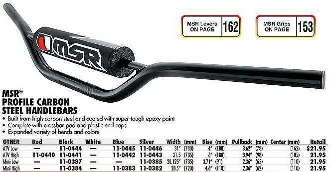

Try the MSR bars. I have them on my V and they are very functional. I got the ATV HIGH and they are about 1" taller than the stockers with less pullback, or angle, on the ends. A big improvement for me. The picture below is from Motovan's catalogue. You can get them cheaper than $22.00 if you try.

I really like my ATV High bars (protaper) but find I still could use some up and back risers. The bars themselves are a big improvement over stock, however, I still get a pinch on long days that I know is related to my seating position.
