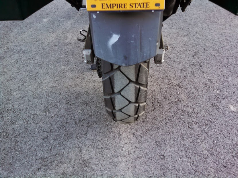

I bought my '08 Wee just about 2 years ago with 12K miles on it from a dealer. I had brand new Metzler Torrence tires and full service done (plugs, oil change, air filter I think). It just clocked over 24,000 miles and all I've done is oil, filter and lube the chain. The rear tire is squared off from mostly commuting but still has passable tread. The front tire has plenty of tread but cupped. The chain and sprockets are in good shape although there is one link that is little stiffer than the rest. The brakes have at least 1/8" of material on all the pads although the front lever gets pretty close to the bars in heavy braking. Still runs great and get over 52 mpg regularly.

Tires - I suspect the tires that originally came on the bike were not balanced from the dealer even though they had replaced them hence the low speed wobble and highway vibration. The shop I took the tires to balanced them correctly. Also noticed the "V" pattern on the front and rear tires are opposite each other. Checked and rechecked and yes, the tires are mounted according to the factory arrows on the sidewalls.
