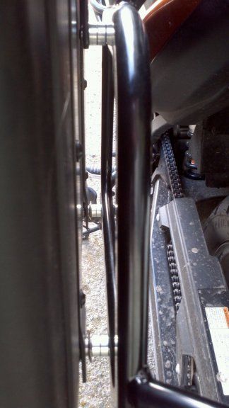

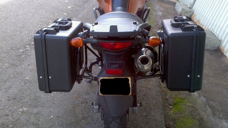

I went with the SW motech mounts, which are "quick disconnect". I wouldn't want to remove them very often. They are a bit of a pain. But once they are on, everything is fine other than some more buzzing in the foot pegs. The buzz is more noticeable with the side cases off. I went with the Twisted Throttle pelican kit, the deluxe version. The cases come off in a second with a key, they also lock which is handy when you want to run into a store real quick. You can use padlocks if you prefer. The lid stays are very helpful in keeping the lid from opening too far.
I did not hack up my turn signals. I went to ace hardware and bought some longer screws and metal spacers for the mounting points on the SW rack on the left side, the turn signal does not touch.
EDIT: The pelican case kit does not come assembled, so be ready to spend a couple hours on that. You will also need a hand riveter.
