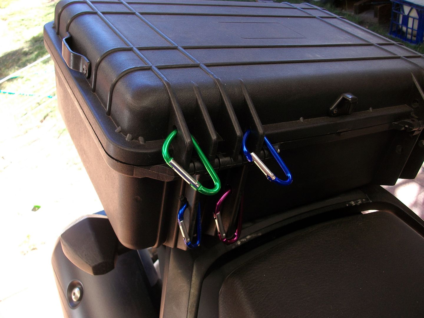

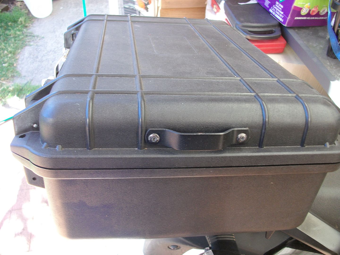

I fabed up a couple of metal hooks to slide in under the front of the OME rack and then used a bolt through the rack and wing nut inside the box to secure it all in place .
I also fitted the lid with some hooks so I can secure things to the lid and still be able to open the box.
I also drilled a few holes through the extra plastic around the hinges to be used for securing other items, EG; tent and gear bag when traveling one up.

Lock and hooks
Strap down point
Holes I drilled
Inside the box
mounting hooks, as the bag is push on the hooks get tighter against the rack.
Mounting bolt
This was made from scrap I had laying around, keep it light as the weight is high on the bike.
