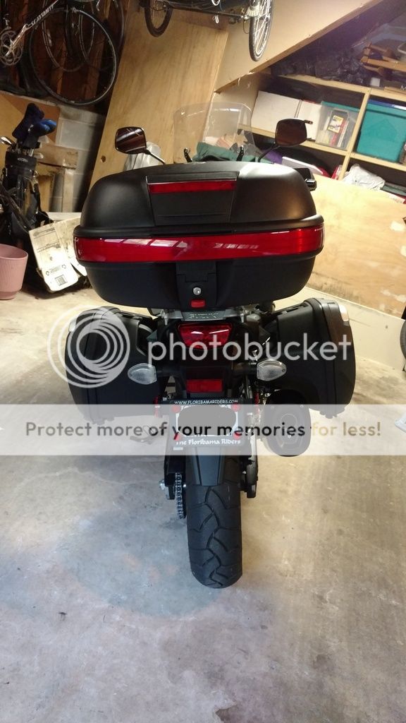

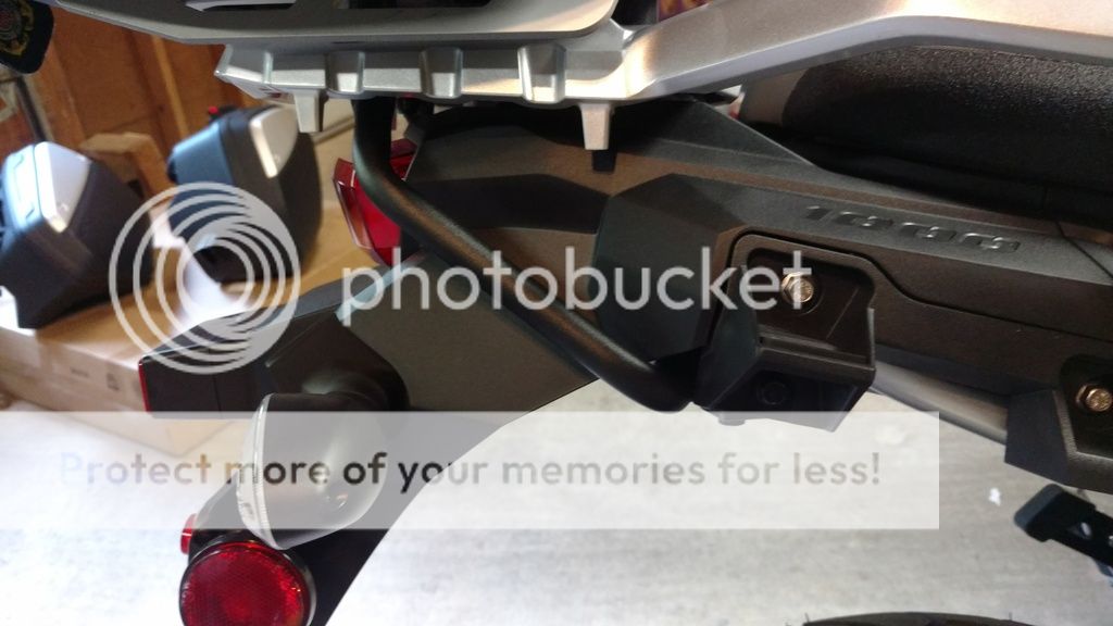

Aramis.. This pic may clear up some of your questions...
A couple others..
The case looks almost comically large in this pic... Its an E460 case and in person it doesn't appear so large..

Thanks! That is exactly what i needed!
