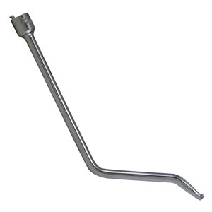

Get the right tool for the job. A hook tool or a brake spring tool makes installing the springs a non-event.

But how am I going to jam that into my palm and give myself a bruised cut full of grease?
It Just wouldnt be the same !
