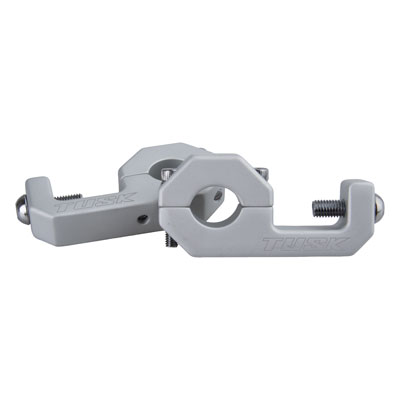

Pretty sure I'd like some Barkbusters. Probably the Storms, 2-point mount version, so as to protect my levers from drops better than the factory plastic handguards.
For various reasons, I've had to rotate the throttle housing down on the handlebar, so that the cables go under the handguard rather than over. Is that going to be a problem?
Every picture I've found of Barkbusters installed on a DL1000 shows the throttle cables in stock (over-the-handguard) position, so I wasn't sure.

You can purchase a set of these which helps avoid cable interference:
