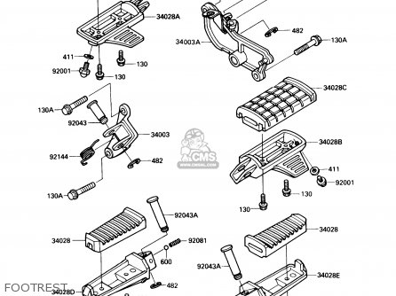

I got my Wing pegs from a guy that swapped em for flood boards on his Wing, $10, I was going to get some Kawasaki Vulcan pegs that looked real trick, but when the guy behind the parts counter said "hey, I got some pegs from my Wing I'll give ya for $10" I couldn't refuse
https://www.bikebandit.com/oem-parts...9157#sch308846
