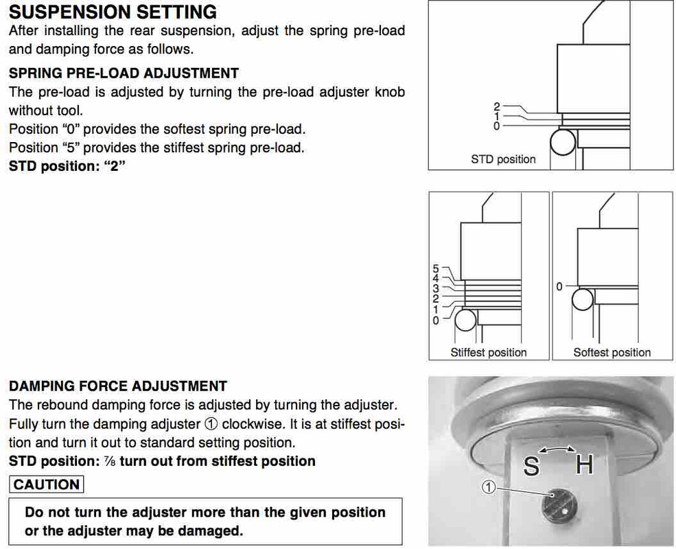

Next question: there are 2 screw adjustments at the bottom of the rear shock; my google ninja skills are failing me. Anybody have a link that shows what those two adjustments do? (I don't have a service manual or even an owner's manual.) (I do know what the big knob does. :-) )
Update: Looks like the one on the right, with the S . H markings, is rebound, and the one on the left, with 4 "dots" around it, is to be left untouched. Correct?
see attached

Thanks @teevee ! I got the download as well.
The grammar in the last paragraph in that screenshot is criminal!!
Once this bike is running again, I'll just do like others have done; set the sag, set the rebound adjuster to the middle setting, then ride and adjust to suit.
