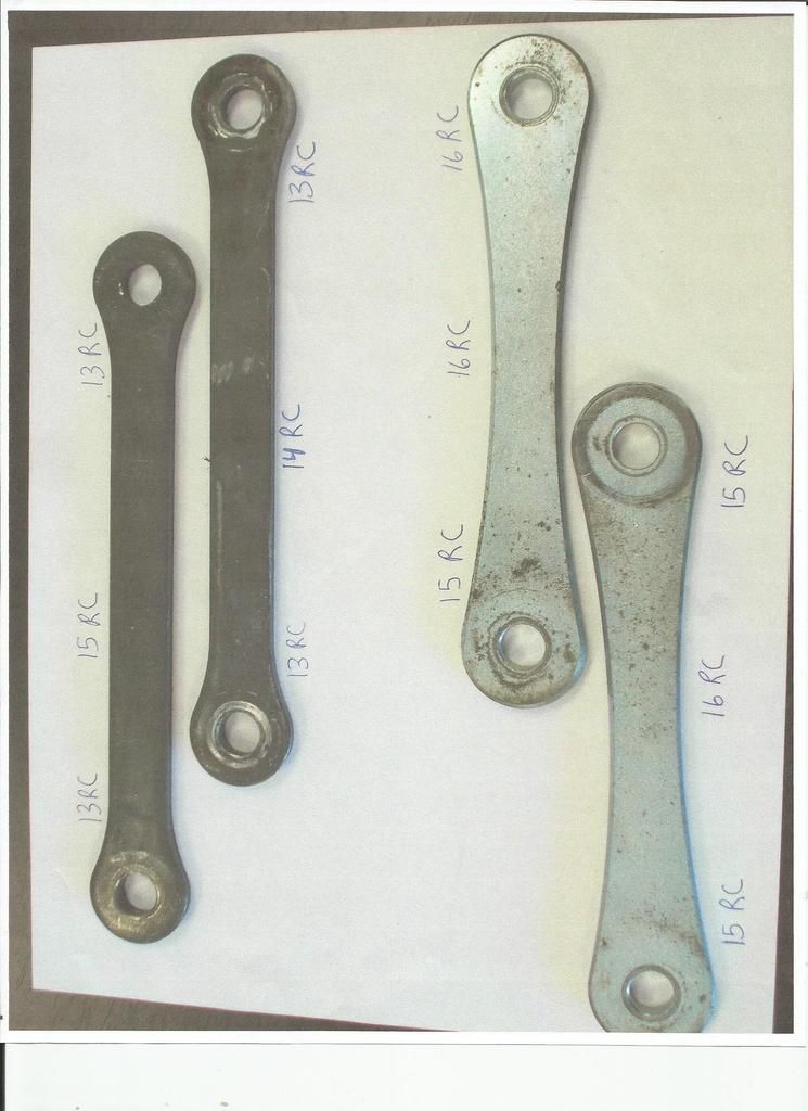

RC scale
Hey Rick,
You might like this; I took my stock Yamaha RSTD links along with a pair of 3/4" lowering links (don't know the manufacturer) and gave them to a friend of mine where I worked and had him check the hardness on them. These are the results. The darker ones are from my RSTD.
Both are soft! but equally soft
