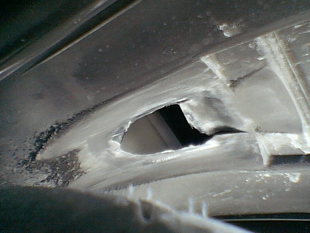

Any more than 21mm in front and 28mm in back on a 2005 Wee can allow the fork legs to crash into the lower triple clamp or the rear tire to crash into the fender. If lower is needed, the fork and shock travel need to be limited somehow.
