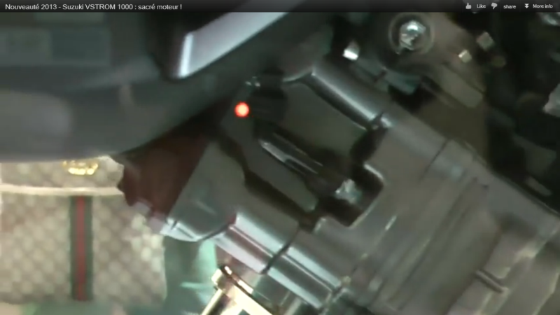

Originally Posted by greywolf View Post
Cars get new engine designs every few years. Suzuki doesn't sell enough DL1000s to redo the engine. The DL650's design is newer and it still got a makeover on 2007 and again in 2012 because they sell more.
Nearly the same engine here in the UK SV1000 has an Oxygen sensor in the pipe beneath the engine and what looks like a small cat in the very front of each can. This since introduction in 2003. I find the engine is smooth in the lower ranges without glitches at all. They could have done the same for US market DL1000.
Perhaps US regulations are not so keen for motorcycles as they are for cars to give the home manufacturers with those old air cooled engines a chance? If Suzuki don't need to spend on modification and extra approval for that market they won't.
Any engine with PAIR is old design trying it's best to be clean for the tests at idle and just off. All pair does is pump air into the exhaust gas as it leaves the cylinder head. Air plays no part in the combustion process as it enters down stream of the exhaust valve. Just thins (dilutes) the dirty gas so it will pass the regulations as it exits the exhaust pipe where it's measured. Test checks volume of dirty gas versus clean gas. Add more clean gas before it comes out the pipe and its said to be a cleaner engine. Truth is it makes just the same muck.
Triumph just fitted PAIR to their latest Boneville engine here. Made to look like a fancy spark plug cover with a plug lead.
I hope to get a good snoop round the new 2014 1K VStrom in a day or so. New cylinder heads will be one area of great interest. Expecting the PAIR system has gone and an extra spark plug in place. Report back if anything worthy of note.

The new motor definately has another spark by the looks of it.
Definately does. Here's hoping the fuei injection is all refined and only sips at it for a decent range.
Clutch cover and Generator covers are exactly the same as existing. Could be they changed the insides without altering the covers. That said I think they would have been tempted to change the style outside to promote anything new inside.
